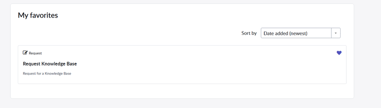

You need to make changes at three places in the HTML Template, this will be the result:

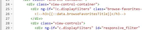

Step 1: Comment out line 26:

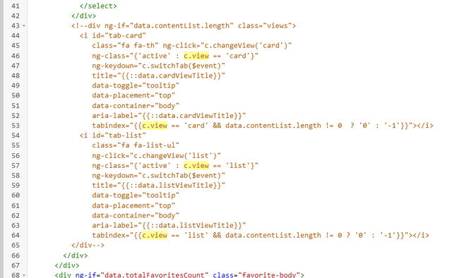

Step 2:  Comment line 43-65
Step 3: remove the ternary operator from line 72
