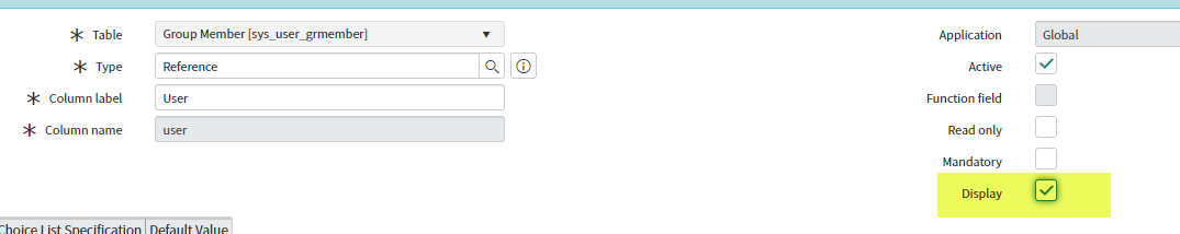

Second - Go to the sys_user_grmember table (sys_user_grmember.list in the filter navigator/search box), right click one of the column headers and Configure -> Table. Click on the User column, check "Display Value" box, and update.
