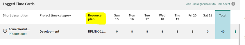

When we add Time Card to Time sheet , there is Resource Plan field as shown in below screenshot. I want to make it as mandatory field. I have made it mandatory for Form view. But I do not know how to do it for Time sheet portal. Please help.

Hi @Talya ,
You can create a Data Policy on Time card table to making that field mandatory. As normal UI policy wont work with Time sheet portal. I tried creating one and have attached the screenshots, let me know if you are struck somewhere.

Hi @VARUN37 - this is quite helpful as I have a similar use case. How did you bypass the Data Policy Exception error message? I need to make Rate type mandatory, but only when the time_card category is project/project task. I created a similar Data Policy, however the system prevented me in adding a project/project task time card.
Any ideas would be welcomed!! Thank you
03-01-2023 03:31 AM
No need to reply on the above, managed to make it work by adding a condition related to State (state=submitted) and now it lets me add time cards, but prevents the system to put the time card in submitted if this field doesn't have a value. Good to know I was on the right track. Thank you
