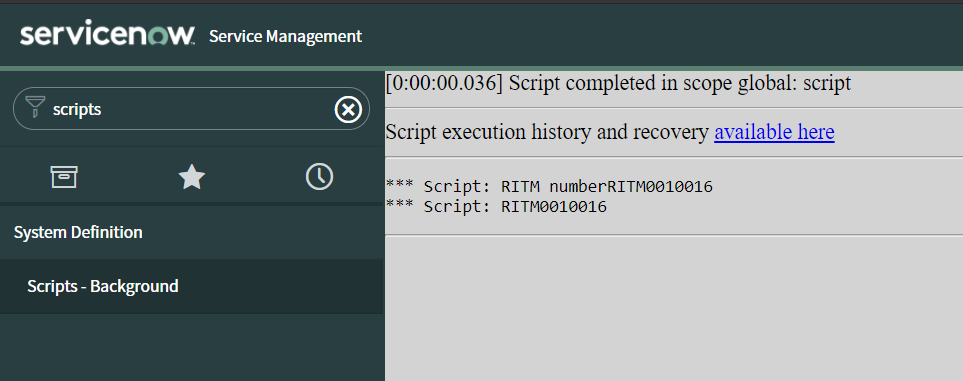

01-03-2021 04:22 AM
see this example which is working fine
You need to pass the object with particular syntax
Script Include:
var getMyDetails = Class.create();
getMyDetails.prototype = {
initialize: function() {
getMyNumber: function(obj) {
gs.info('RITM number' + obj.number);
return obj.number;
type: 'getMyDetails'
Calling it from scripts background:
var ritm = new GlideRecord('sc_req_item');
ritm.addQuery('sys_id', '95cd4c0bdb9d6410224a2a9a48961933');
ritm.query();
if (ritm.next()) {
var gc = GlideController;
gc.putGlobal('ritm', ritm);
var val = "new getMyDetails().getMyNumber(ritm)";
var ret = GlideEvaluator.evaluateString(val);
gs.info(ret);
Output:
Reference:

01-03-2021 04:25 AM
now your updated script below to handle the object
//example logic and code
ritm.addQuery('sys_id', sys_id);// ihave this captured
ritm.query();
if (ritm.next()) {
gc.putGlobal('current', ritm);
var val="new script_include().function_name(current)";
var func_val;
var ct=func_str.indexOf("current");
if (ct >0){
func_val= func_str.substring(0,ct)+
ritm+func_str.substring(ct+7) ;
else{
func_val= func_str;
gs.print( GlideEvaluator.evaluateString(val) ); //new GlideScopedEvaluator().evaluateScript(gr, ' script_field_name',null))
// cannot be use as i dont have a script type field
