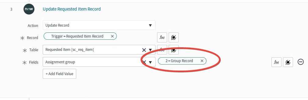

If using Flow anyway, why not use Decision Tables? You can then create a completely code free solution.
Define the decision table that accepts a text input to use in the condition:
AAnd the condition:
find_real_file.pngThen use it in the flow:
Using a Catalog Item variable as below:
And finally update the assignment group:

I think a better and more scalable solution would be to not use branches at all:
In this case the flow looks simpler too:
You will still be able to set the Assignment group as before:
But you will never have to touch the flow again just to add another assignment option. You would only need to modify the Decision Table by adding new Decision answers. Only thing you should make sure is to have a single default last answer.
