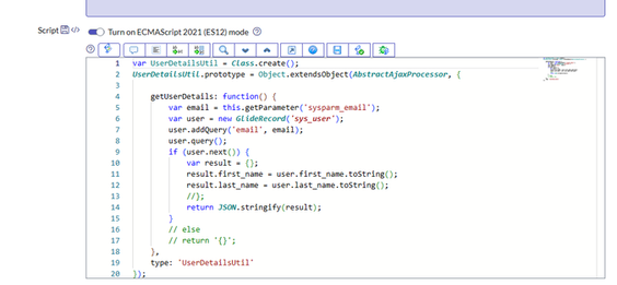

I have created script include (via javascript object) and client script but I am getting wrong first name and last name, every time its showing virtual agent however emaild id is empty for virtual agent user.
Script Include:

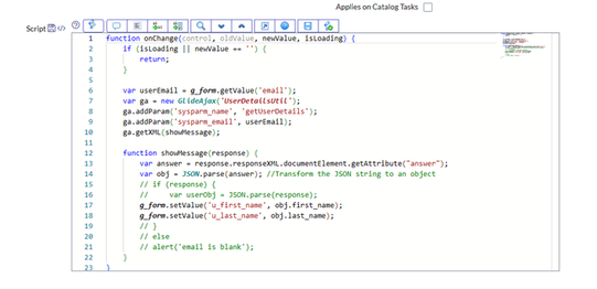

Client script:
I am getting below data:

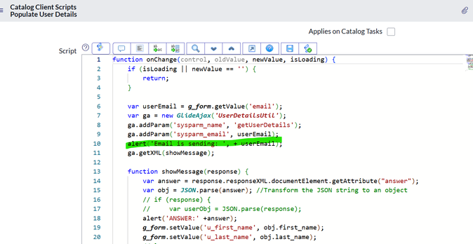

Add alerts in client script and check what email its sending to script include
Add alert to check what answer it is returning.

Update this line in script include
user.addQuery('sys_id', email);
Also in GlideAjax update this line as this
ga.addParam('sysparm_email' , newValue);

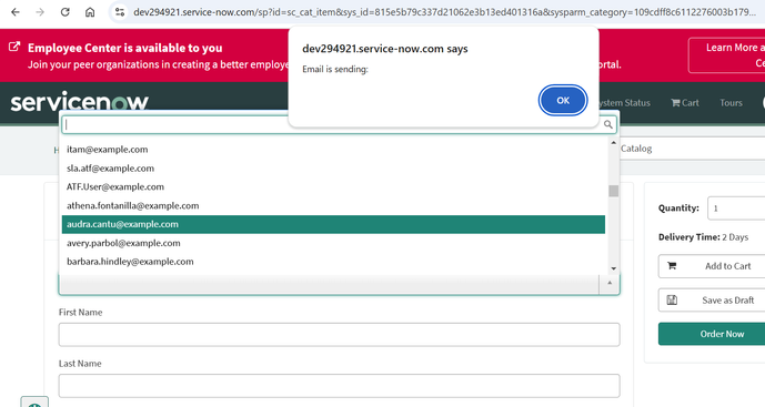

HI @PoojashreeP ,
CS is sending blank email to script include that is why this issue is happening.
I think the issue is occurring at the Catalog item level.
How to fix it. 😞
