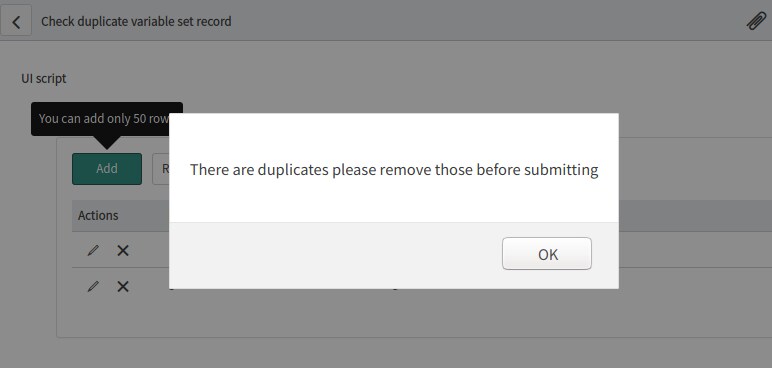

I've tested your code by adding a creating a onSubmit script on the form. If there is a duplicate entry in the mvrs, it would show an alert and stop the submit. (Note, there was no need for another variable on the form.)
Output on submitting a form when there is a duplicate entry in mrvs.
Can you help me with what code did you use to achieve it?
I just used your code but moved it to script on the form (Catalog Client Script) instead of script in the mrvs.
However, I found a way to get the value within the form. Code below will executes is script within the form but will only check on the next new row.
That is, it would only show error if I add a new row, add a duplicate row, then add another row.
It won't error while adding the 2nd row but on the third.

Once i moved the script from Variable set to catalog item, it worked as per the requirement.
Thanks for the help 🙂
