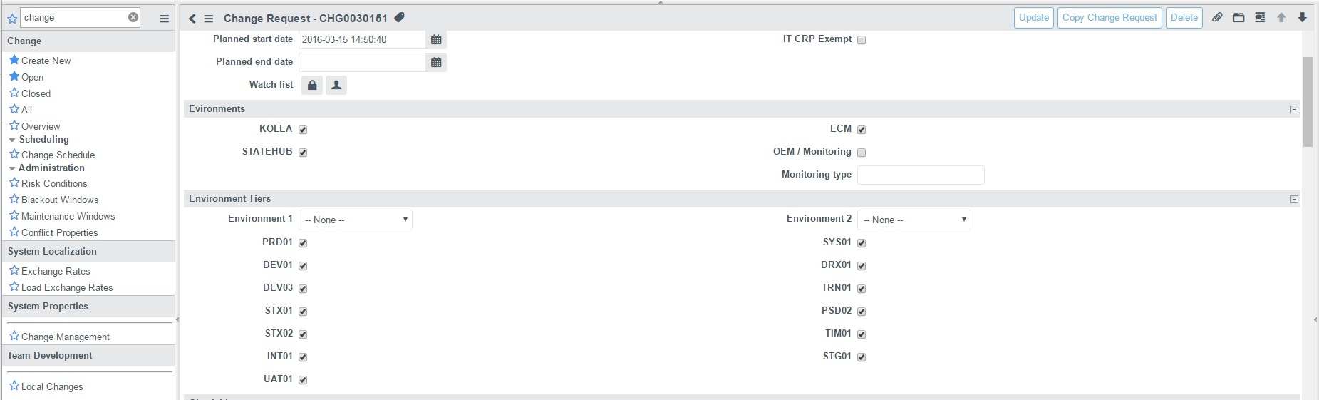

And now it works perfectly when check marked fields are selected.
The following screen shots are the true/false fields that were selected in the Change Request, and thus printed to the email.
Thanks again Christopher et al, you guys rock!
