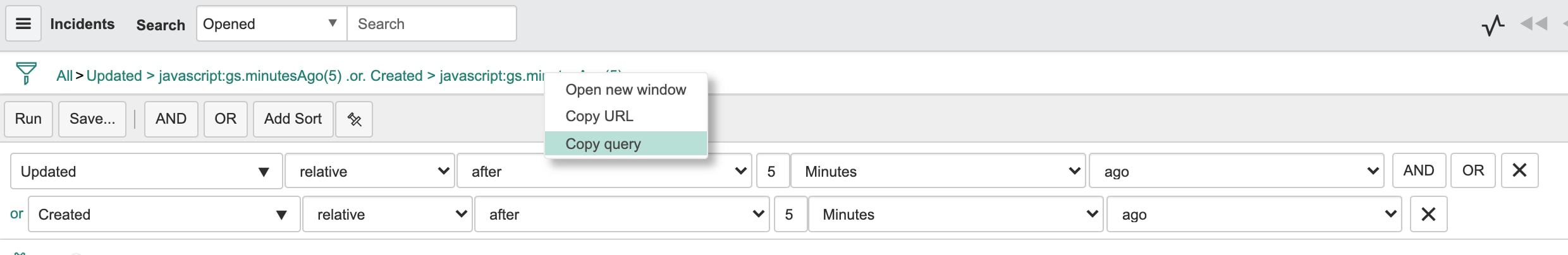

On the incident table build up a query like:
Right click the end of the query to copy query and you get:
sys_updated_onRELATIVEGT@minute@ago@5^ORsys_created_onRELATIVEGT@minute@ago@5
Pass this encoded query as your sysparm_query value.

Thanks Geoff, it working & i am getting the updated records.
