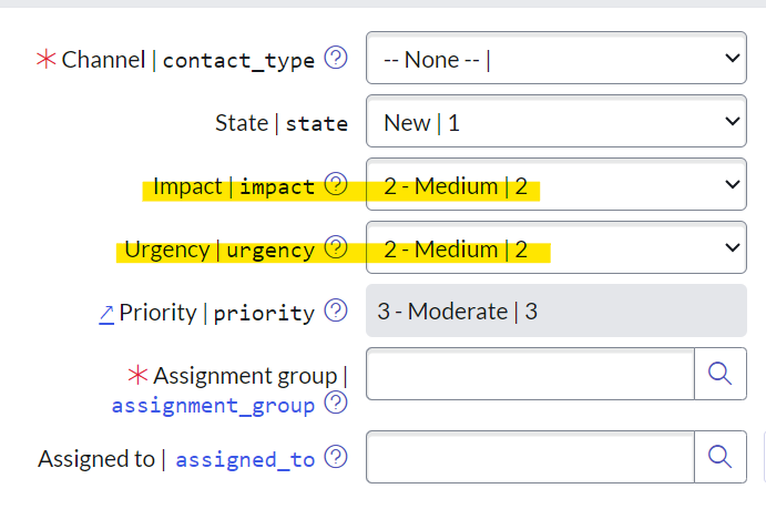

I would like to prevent users from logging a P1 incident. What is the easiest way to hide the 'High' choice on the 'impact' and 'urgency' choice lists? Only 'medium' and 'low' should be visible.
The 'high' option should only be visible to the ServiceDesk.

Hi Sandeep,
Can you please show me, I don't have a lot of coding background and I have been battling since yesterday. I cannot get it to work.
Thereza
Your solution to hide the high priority from urgency and impact worked, but the part I am battling with is to show the high priority to all people in the BST-Service Desk group. They should be the only people who are allowed to use the high priority choice in the list.
