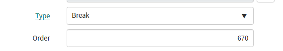

@String To remove options, I create variable of type "Break " and order of this variable should be in between checkbox and other field. I usually name it is as a "formatter".
Then create UI policy and hide it.
