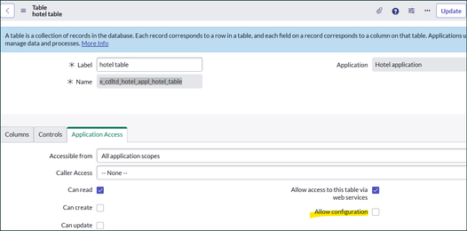

I have created a custom app called HOTEL with a custom table in it. I want to allow other scoped apps read data in this custom table but dont want to allow creation of scripts like Business rules and client scripts in this table.
Hence I have unchecked ''Allow Configuration" and checked 'Can Read'.
But still, from other applications scope, developers are able to choose above table.
ie I have another app called 'AIR LINE'. From that scope, developers can create business rules, client scripts on the table created in HOTEL application.
I don't want that to happen. How to control?
As per docs that should not happen when 'Allow configuration' is not checked.

‎01-11-2025 04:23 AM - edited ‎01-11-2025 04:24 AM
Hello @Ankur Bawiskar
the link that you shared clearly says
"When Accessible from is All application scopes and Can read and Allow configuration are selected, out-of-scope applications can create Client Scripts for the table."
In my case, "ALLOW CONFIGURATION" is not selected in 'HOTEL' application.
Still developers who are in a different scope (AIR LINE in my case) can create Business rules and choose a table which is in HOTEL scope.

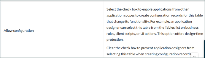

Docs also says clearly:
| Allow configuration | -
‎01-11-2025 05:18 AM
The docs are confusing for Allow configuration.
As confirmed earlier by me to create BR it simply uses "Accessible from" and "Can Read" and doesn't rely on Allow configuration.
