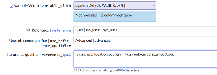

I want to restrict caller filed based on location field value on catalog form.
for example, if I select india location I want only indian users populate in reference filed.
Can anyone help me out.

Hi @anjali viswanad ,
You need to add an advance reference qualifier on the caller field
Replace the variable name (u_location)if it's different:
javascript: 'location.country='+current.variables.u_location;

07-18-2023 11:34 PM
Hi Anjali,
You can use a simple reference qualifier to achieve this.
Go to the 'Configure Dictionary' and set the reference qualifier.
Arun

07-19-2023 03:15 AM - edited 07-19-2023 03:16 AM
My requirement is to restrict caller field based on current location selected by using script.
here both are reference fields.
07-18-2023 11:47 PM
it's not working, when i select location then users are not reflecting in caller field.
