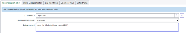

On the Accountable tech organisation field, I'm trying to reference my script include by the following:
However, what I'm finding is that I'm not getting any results at all. Does anyone what I need to do to get the required results?

I hope the code logic and syntax of the Script include is correct. At a first look I found that the syntax of calling the script include is wrong in your SS.
You need to call the a script include as shown below,
javascript: new ScriptIncludeName().LBGfilterDepartmentsAPM(current.department);
