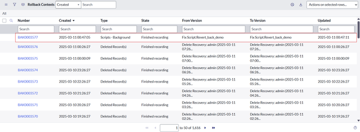

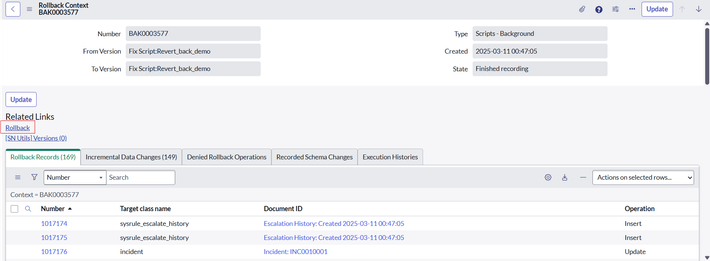

12-30-2022 09:13 AM
Yes, you can if you have checked the "Record for rollback" option for the fix script you ran.
To Rollback the records,
1. Go to --> Rollback & Recovery --> Rollback Contexts.
2. In the "Form Version" column on List view search for "Fix Script:YOUR FIX Script Name" and open it.
3. Click on "Rollback" related list from the record.
4. Type "yes" and press "Ok" if prompted.
Please mark this helpful, if this answer helped you.

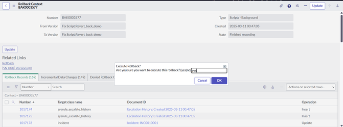

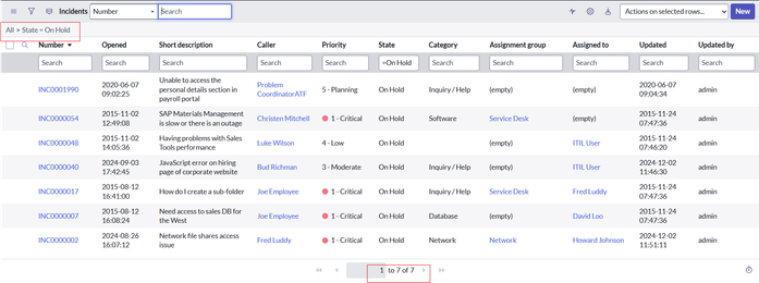

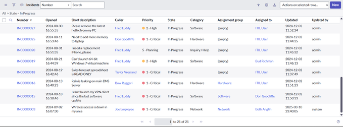

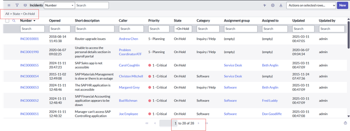

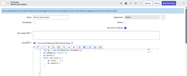

03-11-2025 02:05 AM - edited 03-11-2025 10:35 PM
To revert the fix script, you first need to check the record for rollback for the respective script so that when you run the script, it will be updated in rollback contexts, and it is possible to revert back; if not, it is not possible, I think.
Below I provided you the process for reference.
Here i am converting in progress state incidents to on hold using fix script and reverting
All > Rollback & Recovery > Rollback Contexts
Vasanthi Lankada
