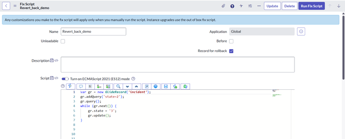

For future update by Fix script use checkbox "rollback".
You need to add on the form as by default not available.

Yes, you can if you have checked the "Record for rollback" option for the fix script you ran.

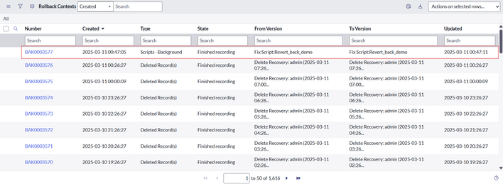

1. Go to --> Rollback & Recovery --> Rollback Contexts.
2. In the "Form Version" column on List view search for "Fix Script:YOUR FIX Script Name" and open it.

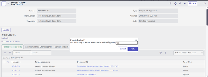

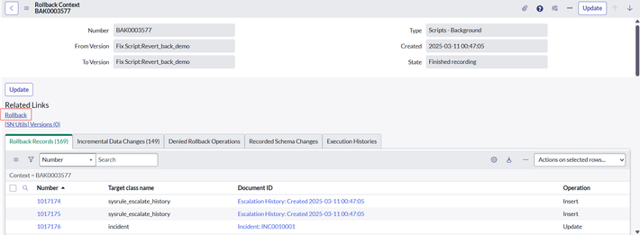

3. Click on "Rollback" related list from the record.
4. Type "yes" and press "Ok" if prompted.

To revert the fix script, you first need to check the record for rollback for the respective script so that when you run the script, it will be updated in rollback contexts, and it is possible to revert back; if not, it is not possible, I think.

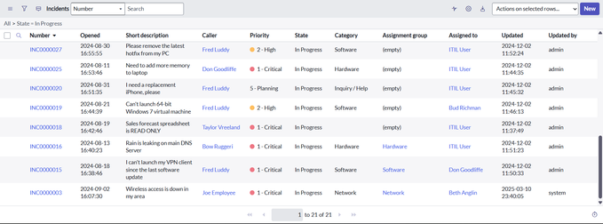

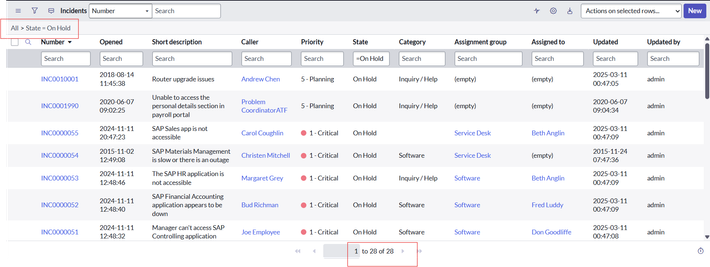

Here i am converting  in progress state incidents to on hold using fix script and reverting
All > Rollback & Recovery > Rollback Contexts
