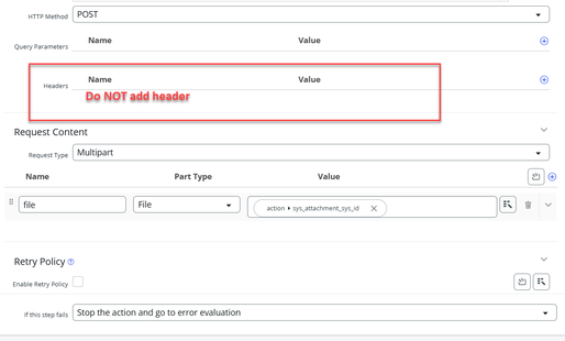

I complicated it with boundary etc... and did not note the RED text in the instructions...
1. create NEW "action". give it a name.
2. when action is created define INPUTS
When inputs is defined.
3. Define connection details. (not documented here on how to do this.)
NOTE: the "BASE URL:"
Note: a way of defining the resoource url part. (this is combined with the base url).
Note: "POST" http method.
4. Do not define header. it will not work if it is defined.
Note: no header.
Note: "Multipart".
Note: "File" AND contenttype and filename "from attachment".
Note: point out to the input defined in step 2.

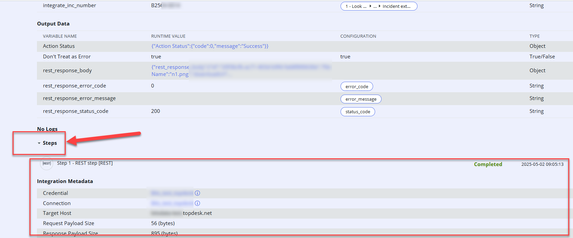

OUTPUT add some output variables storing REST message results.
they can be used in the calling flow.

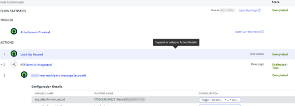

testing:
create a flow that is triggered on insert "after" on the sys_attachment table.
then add the action created. test on a attachemnt and see the results.

c. press "steps" to see the actual data of the rest action results.
