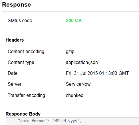

Hi,Zachary,
Thanks for your reply. Could you help me to verify the field value is indeed changed when you do that? Because when I do the exact same thing, I get a 200 OK but the field value never really changed. Here is an example of what I did using the REST API Explorer:
And this is the response, you can see the 'date_format' is not set to null:
And yes, I am on Fuji.
regards,
Haotian
What table is that on? I'm curious if there is an ACL in place that prevents this from being changed? Or perhaps a data policy?
