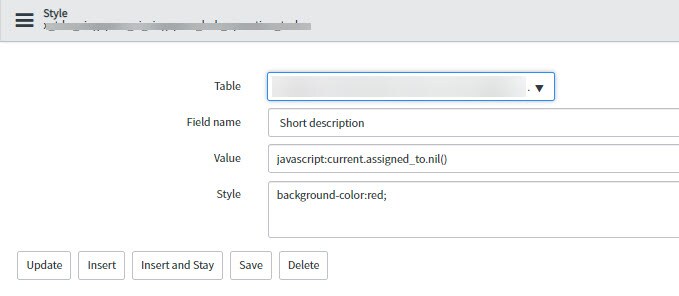

Try us use this, it will work when the field "Assigned to" is empty
javascript:current.assigned_to.nil()
Be mindful that on the field name, I didn't used the field "Assigned to" otherwise it doesn't work. I believe it is because the style doesn't apply on empty field.
Let me know if it helps
