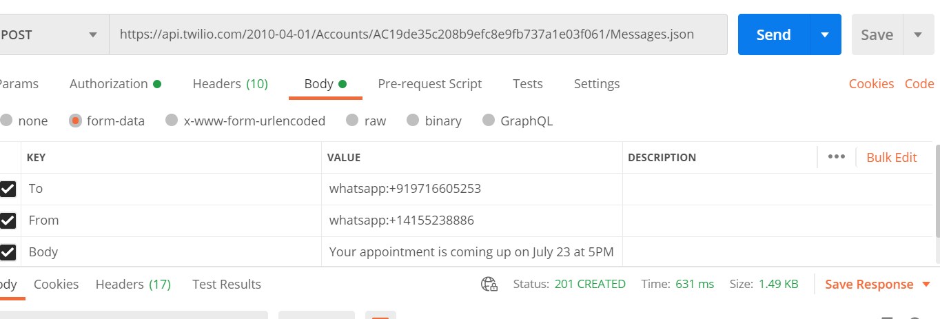

See my response which includes how to do so. (3rd reply to the question)
Hi Brian,
THank you for the quick response,
I have tried but no luck.
I couldn't able to convert into raw format.
would you please help me to get the raw converted format?
You have to manually do that. As stated:
Convert your key: value pair to a raw data format of key=value with an & inbetween value and the next key:
key=value&nextkey=nextvalue&thirdkey=thirdvalue
Thank you, Brian.
