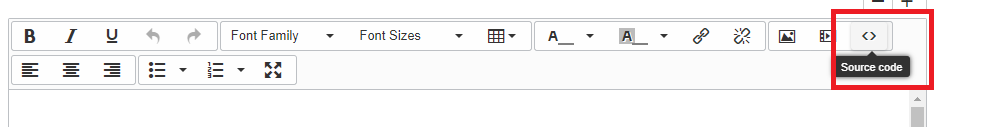

You can copy the HTML source code and use in BR or any script where you are creating the demand.
