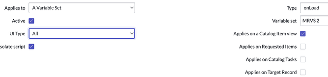

You can do this with an onLoad Catalog Client Script that applies to the second MRVS on the catalog item view
In this example, the internal name of the first MRVS is mrvs1, which contains a reference variable named v_user, and the select box variable in the second MRVS is named v_choice with the choice values choice_1, choice_2, etc., and if any of the rows of MRVS1 contain a certain user selected in the reference, then the third Choice value will be removed from MRVS2.
function onLoad() {
var mrvs1 = g_service_catalog.parent.getValue('mrvs1'); //MRVS internal name
if(mrvs1.length > 2){//native UI returns [] for empty MRVS value which causes a JSON error
var obj = JSON.parse(mrvs1);
for (var i=0; i<obj.length; i++) {
if (obj[i].v_user == '62826bf03710200044e0bfc8bcbe5df1') {
g_form.removeOption('v_choice', 'choice_3');

function onLoad() {
