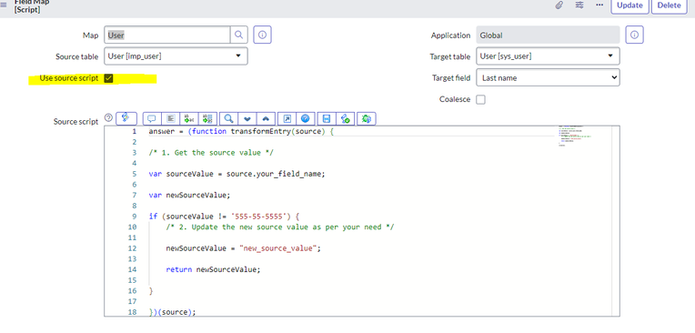

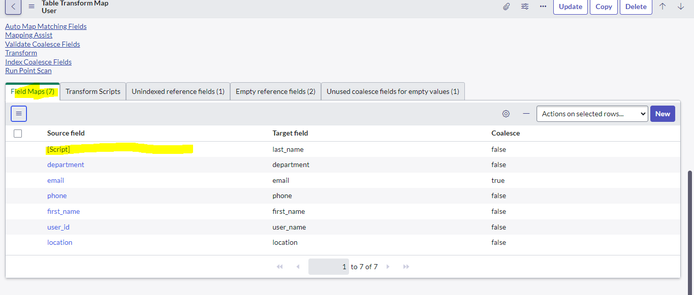

10-24-2023 06:48 AM - edited 10-24-2023 06:49 AM
Hi @Brizky
On Field map entry, You can enable "Use source script" option & write a code as per your need.
answer = (function transformEntry(source) {
/* 1. Get the source value */
var sourceValue = source.your_field_name;
var newSourceValue;
if (sourceValue != '555-55-5555') {
/* 2. Update the new source value as per your need */
newSourceValue = "your_new_source_value";
return newSourceValue;
} else {
return sourceValue ;
})(source);
So source value will be look as like below :
