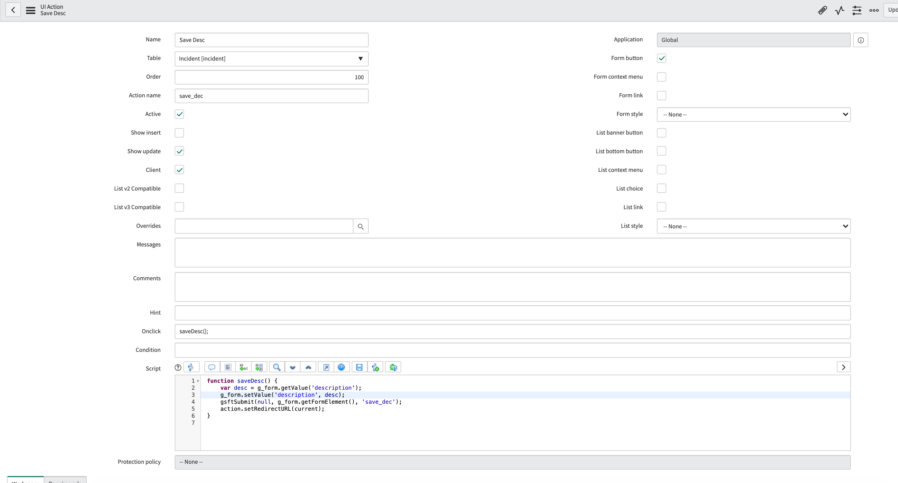

Can you add a screenshot of the entire UI Action?
Best regards,
Pedro
Added the screeshot of the UI action.
Hi
The code is incorrect. action.setRedirect is supposed to be inside the server script instead of client function.
However if you only need to update the field then no need to make the UI action to be run as Client first.
1. Uncheck the Client checkbox
2. Write below code to update the description:
current.description  = "Any value"
current.update();
action.setRedirectURL(current.getLink());
