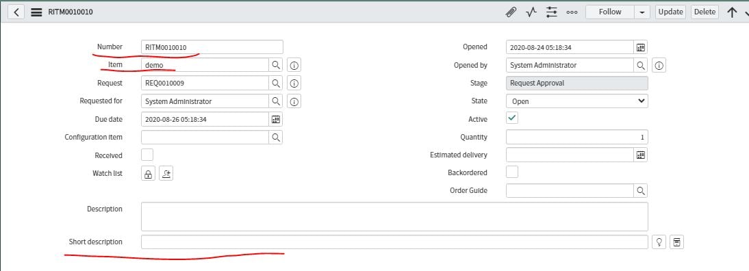

I have a requirement Where I want to update the 'short description' of the catalog item to the 'Name of the catalog item' If short description is empty
What is the best way to achieve it

08-26-2020 02:29 AM
Its not working

08-26-2020 02:51 AM
08-26-2020 02:58 AM
Yes you right, actually when we are updating any record or Inserting a new record it is updating correctly
But I have a situation I want to update on an existing catalog items, I don't want to create an event like insert, update, delete
