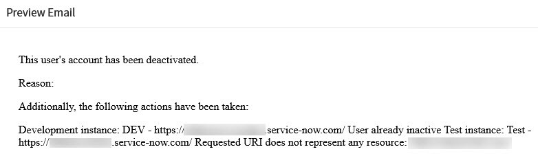

Here is the flow:
The goal is that when a user is deactivated, all accounts for that user are deactivated across all instances.
The output of the script in the body of the email should be formatted like this:
But the formatting required to get it this way always fails. When I use /n as the line break the validation passes and the email sends but it looks like this:
.... I've attached the images as well.
