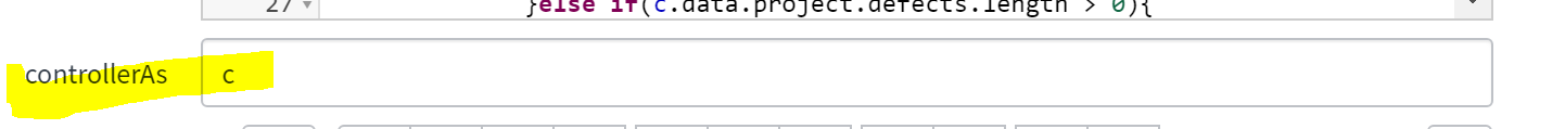

Can you please make sure your widget has the following code wrappers (which are there when you first create it).
You should also have this
If you are missing any of these things, then that will be causing your issue.
Micael Marinho1
Giga Contributor
@Aidan Wardman it's exactly like the widget's default when I created it
