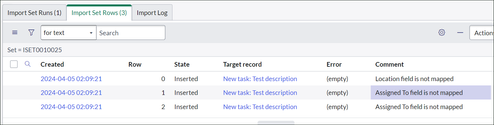

I need to ensure the 2 reference fields 'Assigned to' and 'Location' is mapped in target table once the data transformation is done.
I have written two OnAfter transform scripts like this:
1.
2.

Hi @Suggy,
It's because you are overwriting the value, not appending to it.
Why not have a single onAfter script and use something like below:
status_message = [];
if (target.u_assigned_to == '')
status_message.push('Assigned To field is not mapped');
if (target.u_location == '')
status_message.push('Location field is not mapped');
status_message = status_message.join('\n');

04-04-2024 02:13 PM
Hi @James Chun Yes that works. Thank you soo much 🙂
