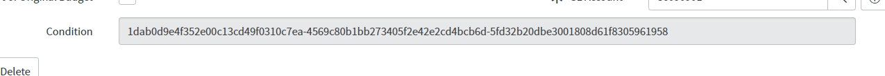

I have a function field that I am trying to concat three separate fields together with "-" in between each. All of these fields are reference fields. I have done it in the past but I can not remember how to write the function so the concat is the display value instead of the sys_id's concat.
Here is my function:
FYI for anyone with the same question:
I figured it out, I was referencing the column names incorrectly when dot-walking..
Ended up being glidefunction:concat(u_cost_center.u_cost_center,"-",u_gl_account.account_name,"-", u_vendor.u_name)
