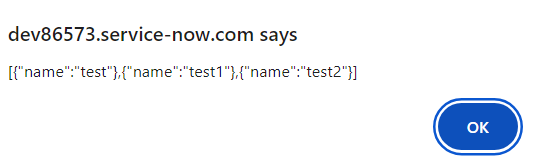

Ravi Gaurav
I have tried the script below and it seems to work for me:-
CS:-
function onLoad() {
var answer = ['test','test1','test2'];
var arr = [];
for(var i = 0; i < answer.length; i++) {
    var obj = { 'name' : answer[i].toString() };
    arr.push(obj);
alert(JSON.stringify(arr));
// Set the MRVS field with the JSON stringified array of objects
g_form.setValue('mrvs_field_name', JSON.stringify(arr));
