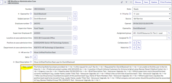

HR Case - short description not reflect correctly on latest version Vancouver
09-26-2023 05:16 AM - edited 09-26-2023 05:25 AM
if user raise request from portal but description field data is not display correctly. in short description add wrong words like <br>./ etc. this problem occurs only on Vancouver version. I have attached screenshot in below
can anyone help me.

Hi @Amol12
Check the record producer script (or any other script where the description field content is being set) for this, the developer is trying to add a new line using <br/> tag but you should use \n to get the new lines in description field.
Please let me know if you need more help.

09-26-2023 05:24 AM
Did you try to debug how description field is getting populated?
that will help you understand the root-cause

Hi Ankur,
I have checked there is a script include used for mapping but this issue is facing on Vancouver version.
