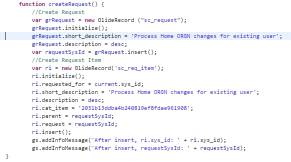

Hi, I am receiving the same error message when I am creating an RITM. The first time I trigger this script, it runs as desired. Subsequent times throws the error message. Debugging the script gives me unique sys_id's for both the RITM and the Request. Can you offer any help?
