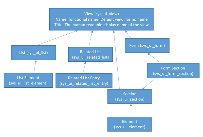

More info :
This is the way the different UI tables relate to each other. The direction of the arrows indicate a reference field pointing from one table to another. So, for example, there are two reference fields on sys_ui_form_section, one pointing to the sys_ui_form table and one pointing to the sys_ui_section table.
I hope this helps...
