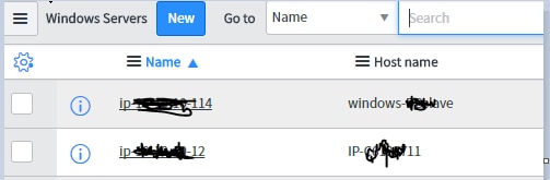

No This is not the case always. Host name and CI name are different for most of the CIs
