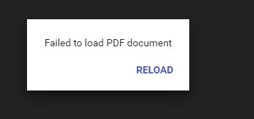

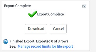

‎02-15-2017 04:08 AM
Hi Ankur,
I have modified my script as per your suggestion.
In my list i have selected 3 records and clicked on my UI action in List Choice.
Then I see this Export Complete along with the message Exported 0 out of 3 rows.
If I click Download,I see this message 'Failed to load PDF' document.
Waiting to hear from you.
Trinadh
