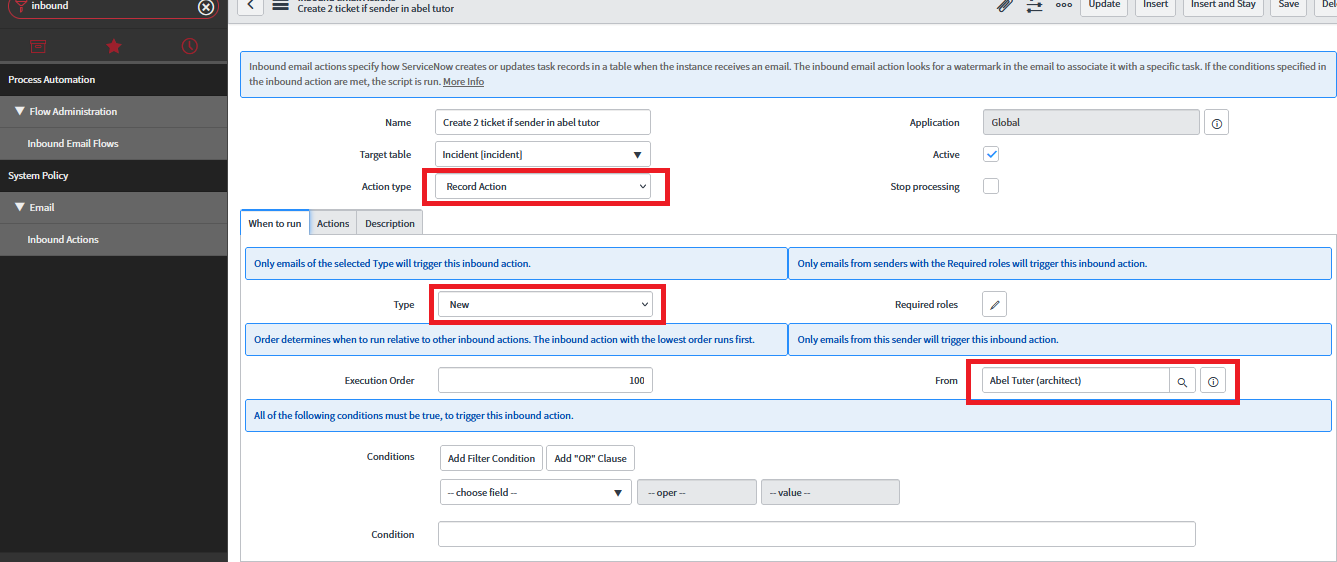

create Inbound Email Action
In Action tab copy and paste below code and change sys id as per your business requirement.

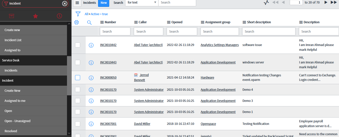

Imran Ahmad
Please send your feedback
