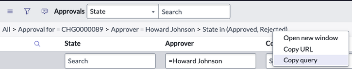

That looks a lot cleaner.  Now you can temporarily add some logs to find out why the GR isn't returning the correct record.  I would also recommend a more standard format like this:
answer = ifScript();
function ifScript() {
    var aprvr = current.variables.who_are_you_requesting_this_software_for.manager;
    var ritm = current.sys_id;
    workflow.info('Approver: ' + aprvr);
    workflow.info('RITM: ' + ritm);
    var strQuery = 'approver=' + aprvr + '^stateINapproved,rejected^sysapproval=' + ritm;
    var gr = new GlideRecord('sysapproval_approver');
    gr.addEncodedQuery(strQuery);
    gr.query();
    if (gr.next()) {
        return 'yes';
    return 'no';
When viewing the executing Workflow Context from the RITM you can check the Log tab to confirm that the script is running and the value of the two encoded query variables.  The resulting encoded query should match the query that you can copy from the filter breadcrumb when manually filtering the approvals list by the same request and Approver.
    gr.query();
    if (gr.next()) {
        return 'yes';
    return 'no';
