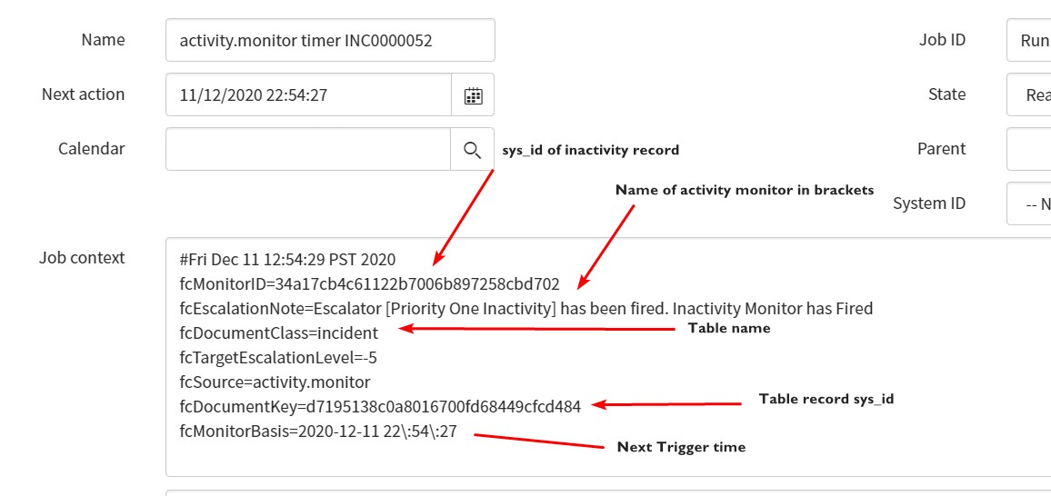

Activity monitors create events <table_name>.inactivity. param1 is the ID of the inactivity, the "instance" will be the table record value. If you go to the sys_trigger table, you should see records with the name activity.monitor timer <record display value> like below. This is what is actually doing the triggering.
If HI haven't helped you with these checks I'd start by,
- Checking the event log tables contains incident.inactivity events
- Check the sys_trigger table to see if any schedule records exist.
