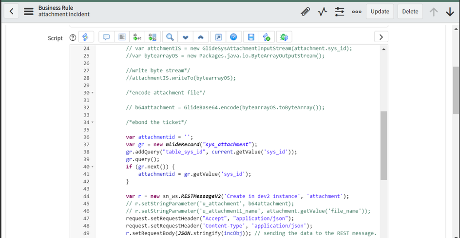

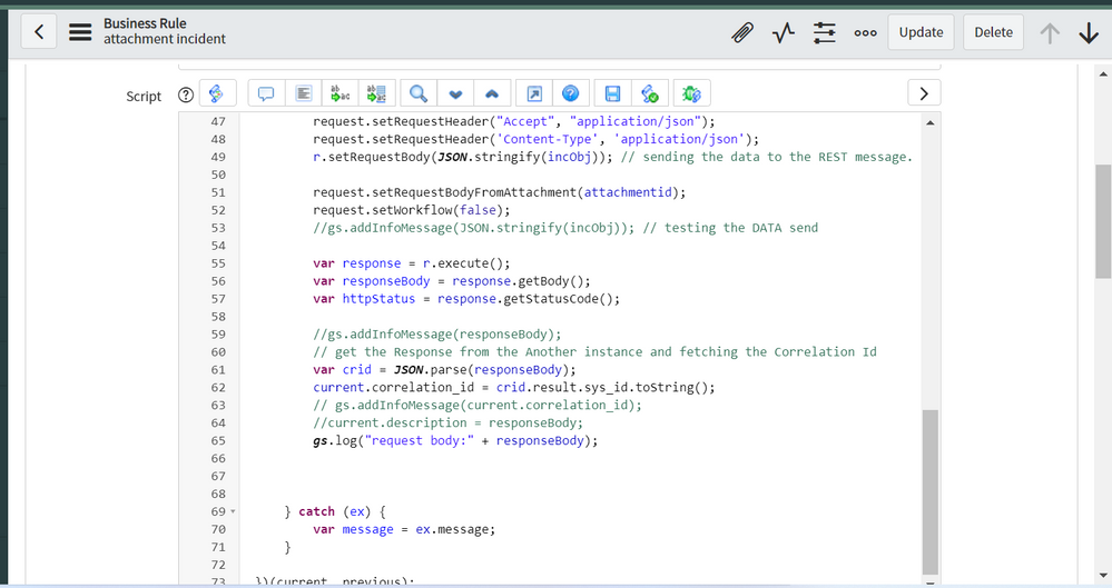

Now we have attachments sending through a rest integration and attaching to our corresponding ticket on the other side I am having a similar issue with attachments being sent to us. our script is below, we pull this data and currently if the pull shows information for an attachment, I then have to separately pull in the attachment and attach it to the relevant record. The original pull is working fine, but when I try to make the second REST call to save the attachment our end, all I’m getting is a statuscode of 0. I’m assuming I’m missing something obvious here but it would be good if someone can point me in the right direction?
This is a screenshot of what we are getting in our pull:
FYI the ‘attachmentInfo’ is the URL of where the attachment is, ‘attachment’ is the url with auth token info etc. using aws.
Here is the relevant section of coding I am trying to use to pull the attachment into our system:
