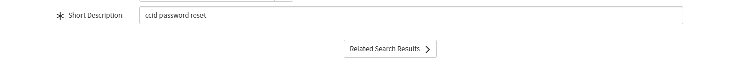

Hello - I have a question Related Search results on the Incident form:
1. On the incident form, I type in my Short Description and find the knowledge article that I want to use/attach to incident. (screenshot 1)
Since I haven't saved the incident yet - I can't attach at this point.
I have to go to the top of the form, right click and save...now I can attach.. so I go back down to the short description.
See screenshot #2
Screenshot 2 - below:
After I save incident .. I then have to scroll back down, click on the "Related Search Results" button again to view knowledge articles again, and then select "Attach" next to the knowledge article.
Is there any way to streamline this so that I can more easily attach a knowledge article to an incident?
thanks

‎08-03-2020 06:46 AM
Hello - once you save the incident, the article is able to be attached.
I am looking at this for our service desk.. what we are wanting our service desk to do is to attach the appropriate article they use to resolve the incident.
