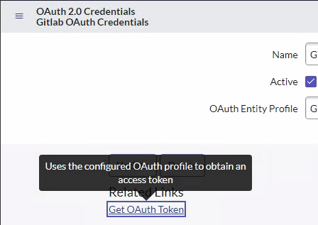

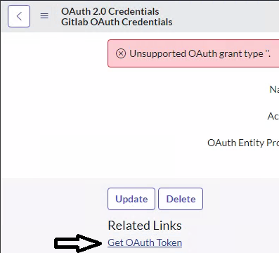

The error comes when I attempt to get the OAuth Token here:

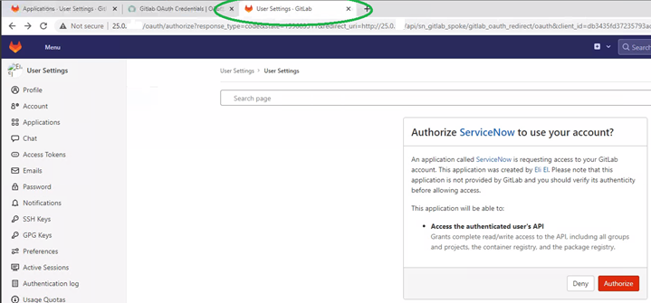

…while logged into ServiceNow as admin, attempt to test it by copy-and-pasting the Token URL {Get OAuth Token} into the browser, I authorize ServiceNow application within GitLab:

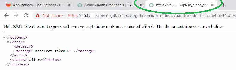

…, then this is displayed:

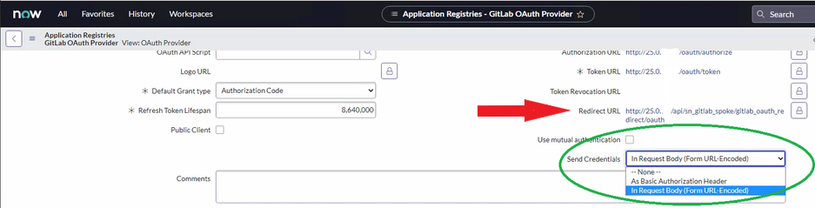

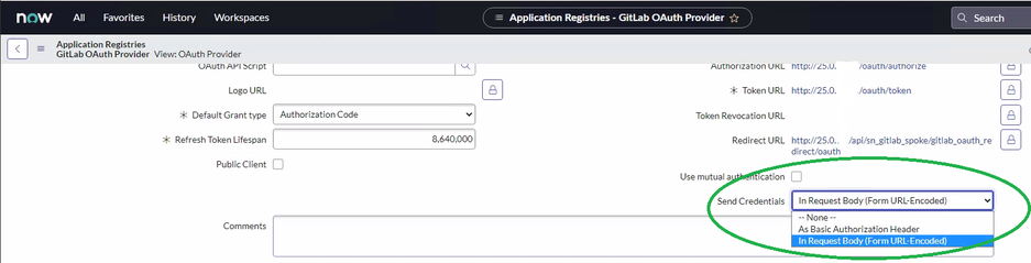

3. The instructions explicitly state that the “Send Credentials” within the ServiceNow Application Registry should be set to <In Request Body (From URL-Encoded)>.
…If I change the “Send Credentials” to <As Basic Authentication Header>, would the change allow me to use the mid-server and the credentials for the GitLab spoke to connect to our GitLab instance while not compromising security?

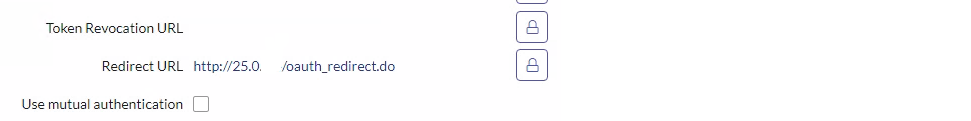

But, change the Redirect URL of the GitLab Spoke settings to:
http://<your_instance_ip>/oauth_redirect.do
Does it now pull the Token correctly? 
This results from changing the redirect:
...And:

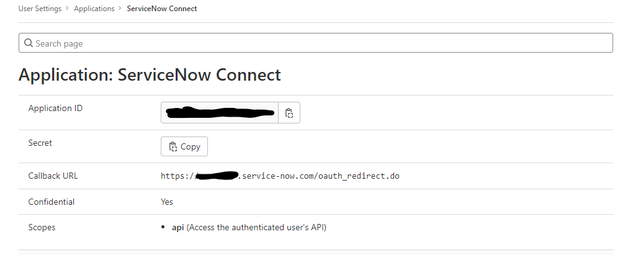

Apologies as I failed to also state that you need to update your GitLab Application Configuration to also reflect the same Callback/Redirect URL.  Did you make those changes as well? 
Here is a screenshot from my GitLab Application Settings -

When performing a test of the GitLab spoke, a secure https GitLab tokenized URL is generated. Our instance of GitLab is rejecting all https URLs, while our ServiceNow instance accepts both https and http. When the same tokenized URL is manually changed to http, copy-and-pasted into a browser, GitLab authorizes ServiceNow to access the GitLab account.
What are ways to re-configure the GitLab spoke to generate a http GitLab tokenized URL OR enable GitLab to accept http and https traffic?
Also, following this manual ServiceNow authorization to gain access to GitLab resources, and failure error is generated in the browser by the ServiceNow URL redirect that reads, "Gitlab Token Management table doesn't have any matching record. please follow documentation to create a record".
What is the root cause and possible ways to mitigate this error?
