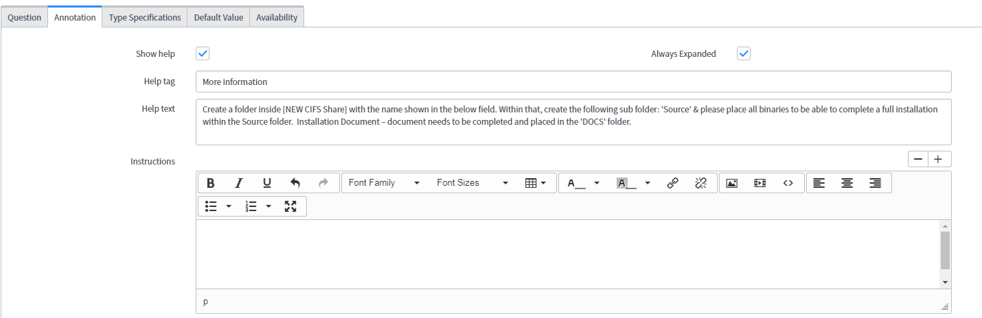

I need some help on this. In my requirement I have a varaible type as LABEL and they provided it with help text where It has hyperlink which should be in blue and underlined. I have no idea to do that in Help text Can you please assist me
Thanks in advance
Rob Smiles
You can use the Formatted Help Text (Instructions) under the annotation tab which works nicely both on CMS & Service Portal.
