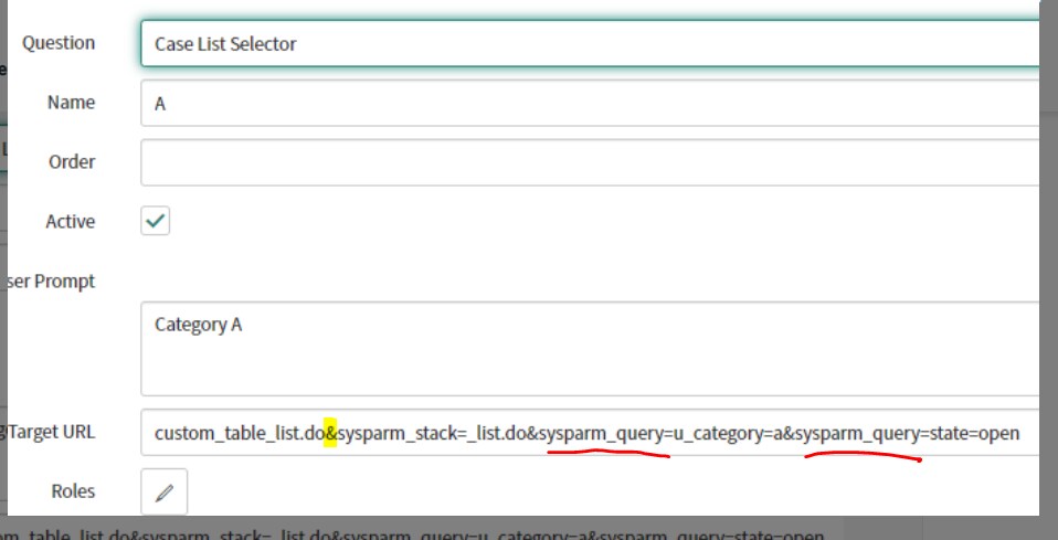

You can use query like below:
/table_name_list.do?sysparm_query=category=a^state=open

In your query you have made mistakes on highlighted parts:
After table_name_list.do use ?, but you have used &. Also two sysparm_querie detected.
