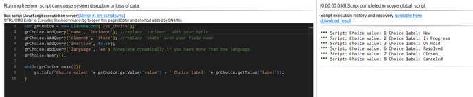

Hello. Here is a simple script that will retrieve data from the sys_choice table, where all the choice definitions reside.
In this example I am retrieving all active values of the state field on the inciden table.
var grChoice = new GlideRecord('sys_choice');
grChoice.addQuery('name', 'incident'); //replace 'incident' with your table
grChoice.addQuery('element', 'state'); //replace 'state' with your field name
grChoice.addQuery('inactive', false);
grChoice.addQuery('language', 'en') //replace dynamically if you have more than one language.
grChoice.query();
while(grChoice.next()){
    gs.info('Choice value: '+ grChoice.getValue('value') + ' Choice label: '+ grChoice.getValue('label'));

Martin Ivanov
grChoice.query();
Please mark Correct and click the Thumb up if my answer helps you resolve your issue. Thanks!

Thank you Martin - this should work. didn't realize there was a separate table for it. Thank you!
