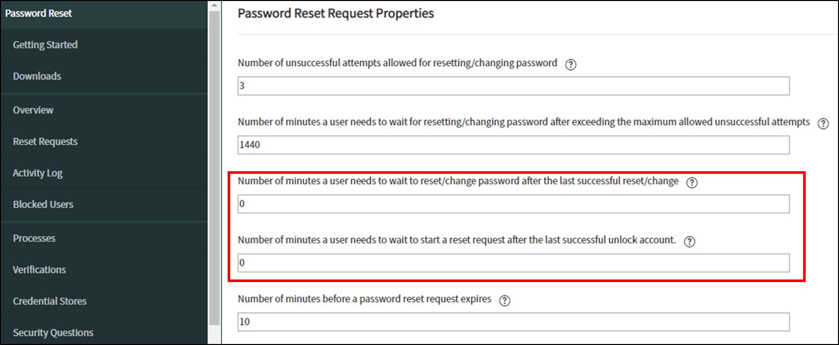

If this error is due to the fact that the user has reset password recently, where can I change the settings so that I can delete the rule that prevent users from resetting password until it passed the pre-defined days(hours) after the user had previously reset password?

Secondly, if a user is blocked, navigate to the blocked users module and find the user record and set the blocked state to false. Also, use 'Properties' module under Password reset to change any time interval settings.

Also, I changed the Property settings to "0"which seemed to be related to time interval settings, but the password change still failed...
Are there other fields in which I should change the value?
