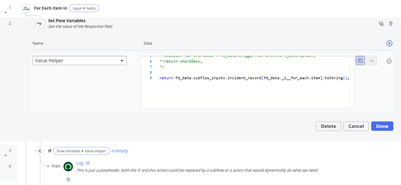

Ok I think I understand your request, so I tried the following, modified my inputs to be an array, so I can pass X number of fields:
Then I use the concept of a for each, and a flow variable, my for each will run on each item of the input array, and it will set the flow variable to the value of the respective GlideRecord passed as input.
At this point, since my flow variable has the value of the GlideRecord for that respective field, I can use it on any logic I want, for example IF conditions. But the ideal scenario would be to either have an action or another subflow that you can call and pass the required info like (GlideRecord Value, and operation to execute).
Either way, using a flow variable allows you to use the values in a data pill format.
Hope it helps
Cheers

I tried the following for your example :
Using an example of an incident record, and a string field name
Then using a log action just for testing purposes :
This allows you to dynamically pass the field name to a gliderecord type of input, and extra the final data :
Off course you could just switch the string input to an array of strings and then make use of multiple input field names if needed.
Hope it helps.
Cheers
Hope it helps
Cheers
