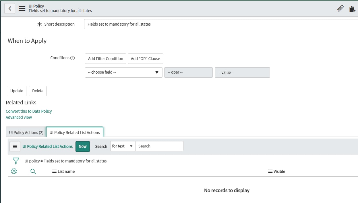

I've a related list defined on a table. I would like to show this tab only on certain conditions. What would be the best way to achieve this? The screenshot below should define what I'm trying to do
One way I can think of is making this return 0 rows so that I can then go to "Right Click->Configure Control->Omit if no records"
But I would be all for not having to query that table at all since it contains 3M+ records and querying through such a large dataset is delaying loading of form on the parent table

Do this
parent object gives you access to current form field values
if(parent.status.toString() == 'active'){
// use your query to show
else{
current.addQuery("sys_id", "-1"); // no records returned using this

What about the order of execution?
If this happens after the source table has been queried, then wouldn't it defeat the whole purpose? What I'm trying to do is not query the table at all if some condition fails.

hello,
Write a onload client script:-
In the if loop write the below:-
g_form.showRelatedList('tablename');
in the else writhe the below:-
g_form.hideRelatedList('tablename');
So this will keep the related list hidden till the condition matches.

I once again ask - if this piece of code runs after the source table has been queried, then it introduces delay in loading the form view.

hello,
Did you try the code and did it introduce a delay or is it just an assumption?
