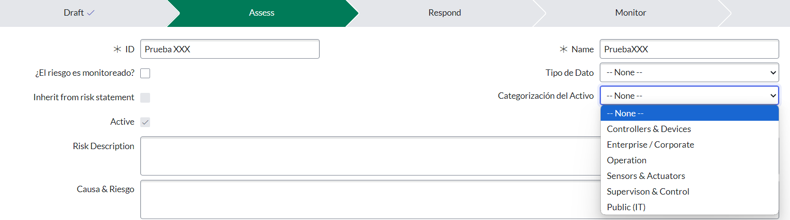

I will appreciate any help.  I want to translate to Spanish different options about the platform, I could do multiples changes with no issues.  Now, I'm trying to set options in choice list but bilingual (english and spanish).
When I use english in the platform, it works fine it only appears english choice options but when I tried with Spanish it appears both (Eng and Spa). I have no idea how can i fix it.

Can you once show the configs of choices please
Deepak,
I attached how the choice list is shown to the user depending on language (eng / spa) and I attached an example about how the choice list is configured.
