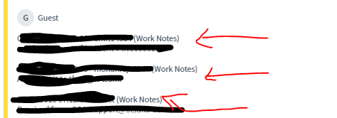

Its a normal transform map with fields maps of attributes including work notes , additional comments . it works fine but I noticed the journal fields are getting stacked in single activity .
Eg: if source records has 5 different work notes after migration it shows 5 different work notes in single activity in target.

@AbdulRahimS2871 could you please provide the screenshot of your issue
10-31-2022 01:47 AM - edited 10-31-2022 01:48 AM
Sure Kamlesh,
issue is multiple worknotes are showing in one activity after migration.
Eg:
Same is happening for additional comments.
10-31-2022 01:58 AM - edited 10-31-2022 01:59 AM
Could you please make your transform map not run Business rule and transform your data. I beleive there is any BR which is doing it. Please make change as indicated below and see if it works for you.

Hello Kamlesh,
In my Tms run Br is false only so i believe it is something else
