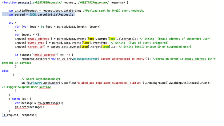

I'm trying to parse information (highlighted fields in yellow attachment payload) from an Okta json suspend event payload that has a multiple arrays and then calling a sub flow to suspend the user in ServiceNow.
Please see payload attachment.
Here's scripted REST API.  It works if I put [0] where yellow highlighted but when I use [loop] it does not.  This payload can contain multiple suspends and that's why I cannot use [0].
2 ACCEPTED SOLUTIONS
There is an error in your code: the for loop variable needs to be checked against parsed.data.events.length not parsed.data.length.
As for the original problem: there needs to be an additional loop, one that goes through targets:

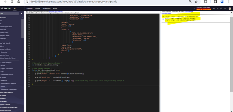

/* Dot walk to events & get events data */
var eventData = payLoad.data.events;
/* Loop through eventData */
for(var i=0 ; i<eventData.length ;i++){
    /* Get desired data */
    gs.print('Acrtor . Alternate Id=' + eventData[i].actor.alternateId);
    gs.print('Event Type=' + eventData[i].eventType);
    gs.print('Targer . Id =' + eventData[i].target[0].id);  // If target array have multiple values then you can loop throguh it
/*You can use your logic in for loop*/

Hi @Sandeep Rajput
Can you please explain?  Here's my code.
(function process( /*RESTAPIRequest*/ request, /*RESTAPIResponse*/ response) {
var initialRequest = request.body.dataString; //Payload sent by Okta event webhook.
var parsed = JSON.parse(initialRequest);
try {
for (var loop = 0; loop < parsed.data.length; loop++)
var inputs = {};
inputs['email_address'] = parsed.data.events[loop].target[0].alternateId; // String (Email address of suspended user)
inputs['event_type'] = parsed.data.events[loop].eventType; // String (Type of event triggered)
inputs['target_id'] = parsed.data.events[loop].target[0].id; // String (Okta unique ID of suspended user)
if (inputs['email_address'] == '') {
response.setError(new sn_ws_err.BadRequestError('Target alternateId is empty')); //Throw an error if email_address isn't present in payload
} else {
// Start Asynchronously:
sn_fd.FlowAPI.getRunner().subflow('x_abcd_acc_repo.user_suspended__subflow').inBackground().withInputs(inputs).run(); //Trigger Suspend User subflow
} catch (ex) {
var message = ex.getMessage();
gs.error(message);
})(request, response);
